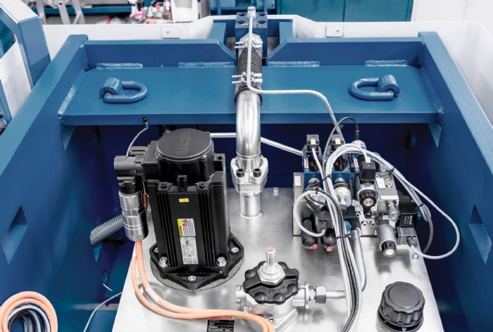

Advancing technology provides a wider range of choices than ever. In certain cases, switching from older technology offers the best option for improved machine performance. For example, upgrading an existing press from traditional hydraulics to servohydraulics, or to a hybrid system, can bring a substantial upgrade in machine capability. Control of speed, force and torque along with other enhancements all result from upgrading to a servo system. Adding a servo motor to a pump to create a hybrid system can yield similar benefits.

But even in high-tonnage applications, users still have noise-reduction options. Variable-speed hydraulic pump drives, such as Rexroth’s Sytronix pump, can achieve noise reductions of as much as 20 dB. Implementing these drives in multiple machines within a single factory offers considerable improvement in operator comfort and, consequently, productivity.

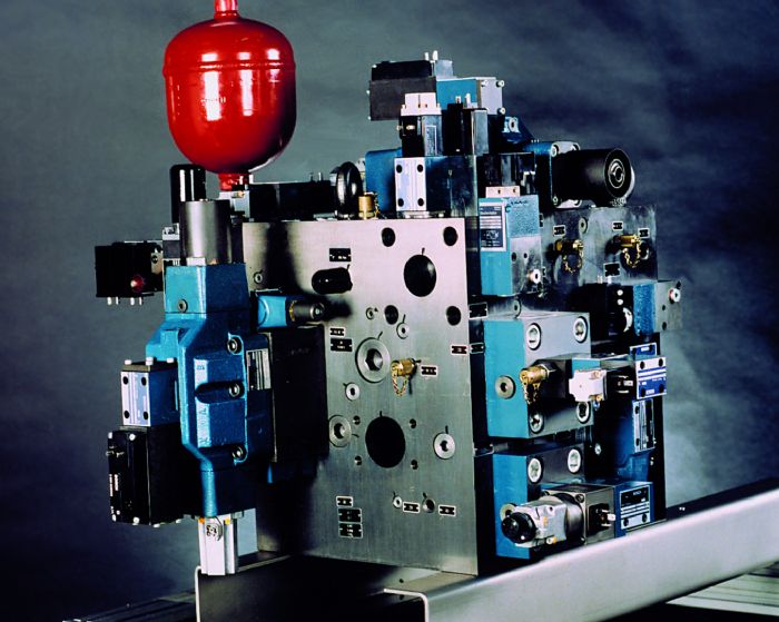

In addition to control electronics, press-component safety features also continue to improve. Press safety blocks, for example, can be implemented into the hydraulic circuit of existing machines for added safety. Used mostly in down-acting machines such as stamping lines, cold-forming machines and peripheral equipment, retrofit-friendly safety blocks add a good measure of protection.
However, safety always should be viewed holistically when evaluating upgrades. If not integrated into the machine control, even simple upgrades such as safety blocks will be ineffective. Constantly advancing, controls, safety blocks, and safety programmable logic controller or I/O technology each bring new safety capabilities to the manufacturing sector. Implementing all safety features and components, if not connecting them to a machine safety infrastructure, provides little value to production.

One example: modern variable-speed pump-drive technology, such as the Sytronix pump drives mentioned above. These pumps provide power at the required levels only when needed during press operation, significantly reducing the required rotational speed and the total pump-drive travel. This not only offers energy savings of 30 to 80 percent during typical operation, but also reduces heat generation and component wear. Even in applications with less-significant energy savings, retrofitting presses with such technology still significantly lowers operating costs through a combination of increased energy efficiency and component longevity.
