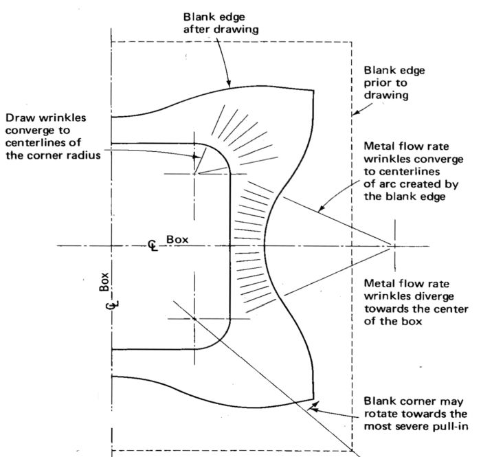

Note that material flow in the corner of the box (Fig. 1) formed from a rectangular blank appears much like one-fourth of a cylindrical cup formed from a square blank. The corner tab of the blank not only has a much-larger-than-necessary draw ratio, but the triangular tab of the corner acts as a structural feature, preventing material from flowing into the sidewall area.
Mitering and contouring the corners will improve the ability of the blank to flow into both the corner wall and the adjacent straight sidewalls. Inserting offsets, darts or other features into the straight sidewall near the corner will impede any compressive stress relief from the corner into the sidewall.

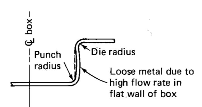

The longer the box sidewall the more freely the material can flow. The fast movement of material into the flat box wall often results in excess material. Rather than a tight sidewall, it instead slightly curves from punch radius to die radius (Fig. 2). This frees the box to oil-can, or snap back and forth when a load is applied. Possible solutions: Add draw beads, spot the blankholder (or die) face, sharpen the die-entry radius, or tailor lubrication at the corners (to reduce friction) and the sides (to prevent galling).
Sidewall wrinkles associated with flow rate, also called flow-rate wrinkles, diverge toward the die radius (Fig. 3). The cause of these wrinkles differs from that of the convergent draw wrinkles at the box corners.
