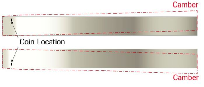

Another option: Coin a shallow chisel-point depression in the top surface of the concaved side of the coil strip in an area outside of the finished part or in the part carrier (Fig. 2). Coining the material will elongate the edge slightly to help even out the camber. The depth and location of the coining can be adjusted to suit the prevailing camber condition.

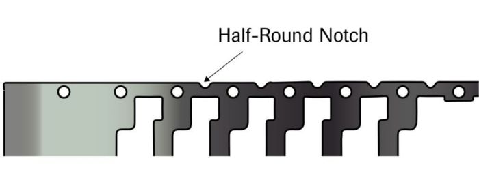

Fig. 4Some die operations cause the progressive-die strip to camber due to cutting stresses and the relieving of internal stresses in the strip—prevalent in strips that carry parts on one-sided carriers requiring large amounts of gutting or cutouts. Adding a half-round notch in the carrier between the pilots can help balance the stresses (Fig. 3). The notching station should be adjustable for the initial die tryout, enabling movement of the notch depth inboard or outboard to achieve the desired results. The station then can be doweled permanently in place or left adjustable.

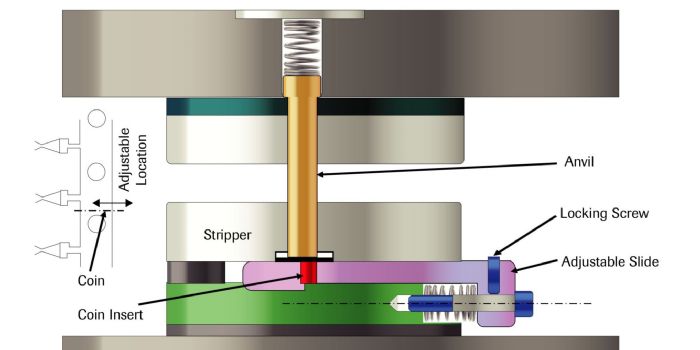

Another option for controlling stamping-induced camber: Add an adjustable coining station in the die that imparts a small chisel-point depression in the carrier (Fig. 4). This method proves useful in dies that run thin materials, such as those used to stamp electrical terminals.
