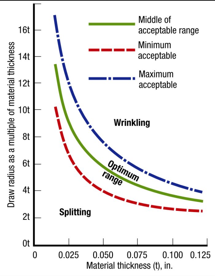

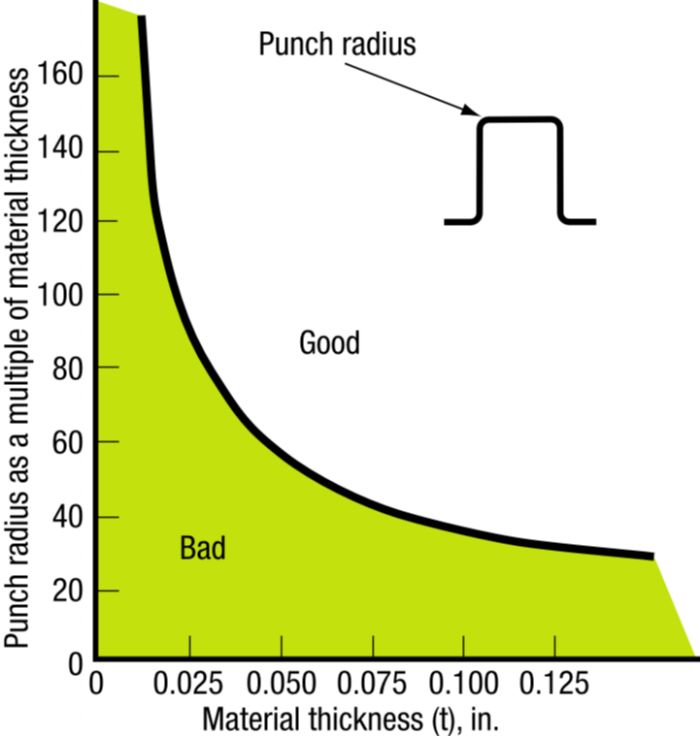

Do not consider the LDR measured in the laboratory as an absolute value that must be applied in the press shop. Like all forming operations, the product and die design represent two of many variables in the forming process. The LDR can be tweaked by proper design of punch and die radii based on sheet metal thickness. Figs. 1 and 2 illustrate recommended punch and die radii as a function of sheet thickness, respectively.

When redrawing operations are required, neither the shell diameter nor height approaches the final part-print dimensions during early draw stages—no need to use the part-print radii here. In fact, using a larger punch radius in the draw operation offers an advantage because the redraw blankholder fits inside of the drawn cup at this radius. This provides for a larger redraw radius on the blankholder, thus reducing bending and straightening loads for that operation.

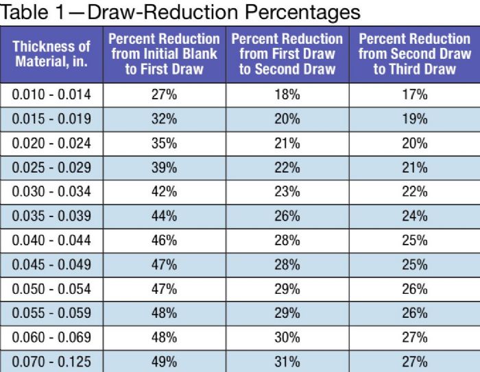

The redraw-reduction percentage never reaches the percentage of the first draw reduction due to more bending and straightening forces in the redraw, a smaller cup wall in tension, and previous work hardening of the metal. Consequently, reductions for the first redraw usually measure 55 to 60 percent of the initial draw reduction.
For example, given a first draw reduction of 48 percent, the first redraw reduction would be 48-percent initial blank reduction times 0.60, or a 29-percent reduction in diameter. The next redraw-reduction percentage must be less than that of the first redraw due to more severe workhardening plus an even smaller cup wall in tension. As a rule, any subsequent redraw reduction measures approximately 10-percent less than that of the previous redraw. So, given a first redraw reduction of 29 percent, the second redraw encompasses a 26-percent reduction; the third redraw, 10-percent less than the second, provides a 23-percent reduction; and the fourth redraw, 10-percent less than the third, a 21-percent reduction.
The Draw-Reduction Percentages table reflects this pattern, but different handbooks may provide slightly different reduction sequences. Keep in mind that most existing tables were developed empirically (trial-and-error) using a specific lubricant, material type and grade.

Table 1--Draw-Reduction PercentagesDeep drawing of stepped shells basically follows the same procedure as that for a cylindrical part. If the draw reductions for the adjacent steps fall within the allowable percentage, each step equates to the drawing of the corresponding cylindrical part, but with each redraw operation stopped part-way to establish the corresponding step height(s).
