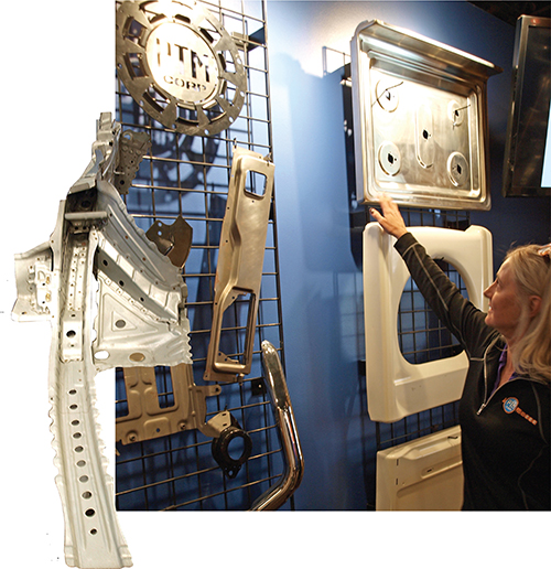

Since adding its 550-, 600- and 1000-ton presses, PTM now has been able to stamp nearly every part of a vehicle, says Russell-Kuhr, noting that some 14 percent of the company’s business is for GM, and the business plan requires that no one customer account for any more than 20 percent of its business. In addition to automotive work, we spied in the company’s customer showroom stamped prototypes of stove tops, washing-machine parts, heavy-truck oil pans and seat-actuator parts, to name a few.
