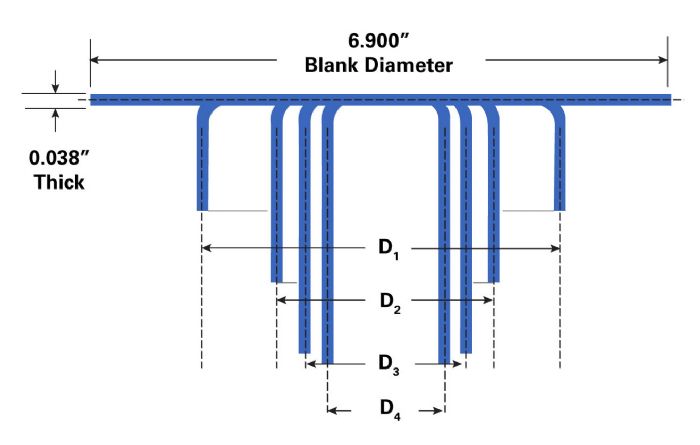

Assume that a 6.900-in.-dia. blank, with a nominal thickness of 0.038 in., must be reduced to a 2.100-in.-dia. cup (Fig. 1). From the draw-reduction table, the recommended reduction ratios for 0.038-in.-thick material are 44, 26 and 24 percent. To minimize the number of reductions, the designer decides to apply these recommended values:
Blank diameter = 6.900 in.
First draw (D1) 44 percent = 3.864 in.
Second draw (D2) 26 percent = 2.859 in.
Third draw (D3) 24 percent = 2.173 in.
After three reductions, the shell diameter measures 2.173 in. Achieving the desired diameter of 2.100 in. requires an additional 0.073-in. reduction. The designer may decide to add a ‘sizing’ station to achieve the final size, or increase the first draw reduction to 46 percent to achieve the final diameter in three reductions. Although both approaches may work, neither represents an ideal solution.
