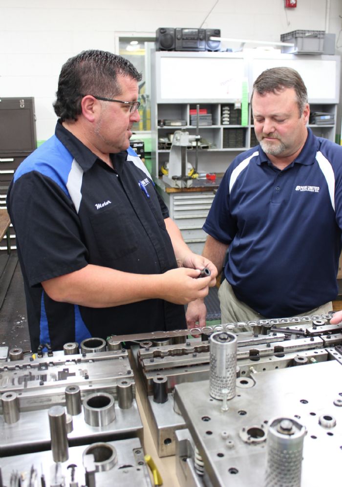

With parts customers of Penn United Technologies, Inc. trying to do more with less, and designing components that depend more and more on smaller cross-sections while needing to support higher loads, higher-strength part materials often get the call. As a result, reports Jim Marraccini, engineering team leader at metal-parts/components supplier and die builder Penn United Technologies, high-strength stainless steels often are the part material of choice.
Phygen-tool-coating-punch“In turn, our forming and drawing punches and dies experience more contact forces than in the past,” Marraccini says. “Also, using higher-strength materials eliminates the need for secondary operations such as heat treating. Some parts in the past were made from annealed materials and heat treated in a secondary operation.  To reduce costs involved in a secondary heat treating process, these materials have been switched to higher-strength grades.”
Bottom line: Increased use of higher-strength materials stresses tooling components. To combat such challenges, Penn United opts to coat selective die components and tooling faces to increase tool life and better prevent issues such as galling.

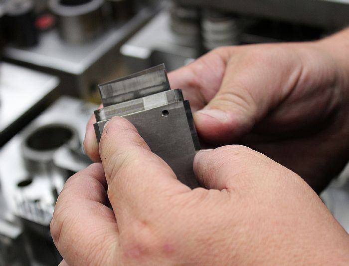

Phygen-tool-coating-part-slotWith its inhouse tooling expertise, Penn United is quite well-versed in determining, during design, the potential trouble spots in tooling where coating proves advantageous, or in identifying areas on current-production tooling that can benefit.
“Most of the time throughout our design reviews we'll have a good idea of what details may need to be coated, based on past experience with similar applications,” Marraccini says. “Here, we’ll have the tooling coated before we hit the die for the first time. Or, throughout the course of debugging a tool, we may see galling or premature wear on some details. Once identified, we’ll rework the details and send them out for coating. The same holds true when identifying issues in current-production tooling. Overall, we typically only coat surfaces that we feel will be problematic, or that we have later found to have issues with. For the most part, these include forming or coining surfaces and not trims.”

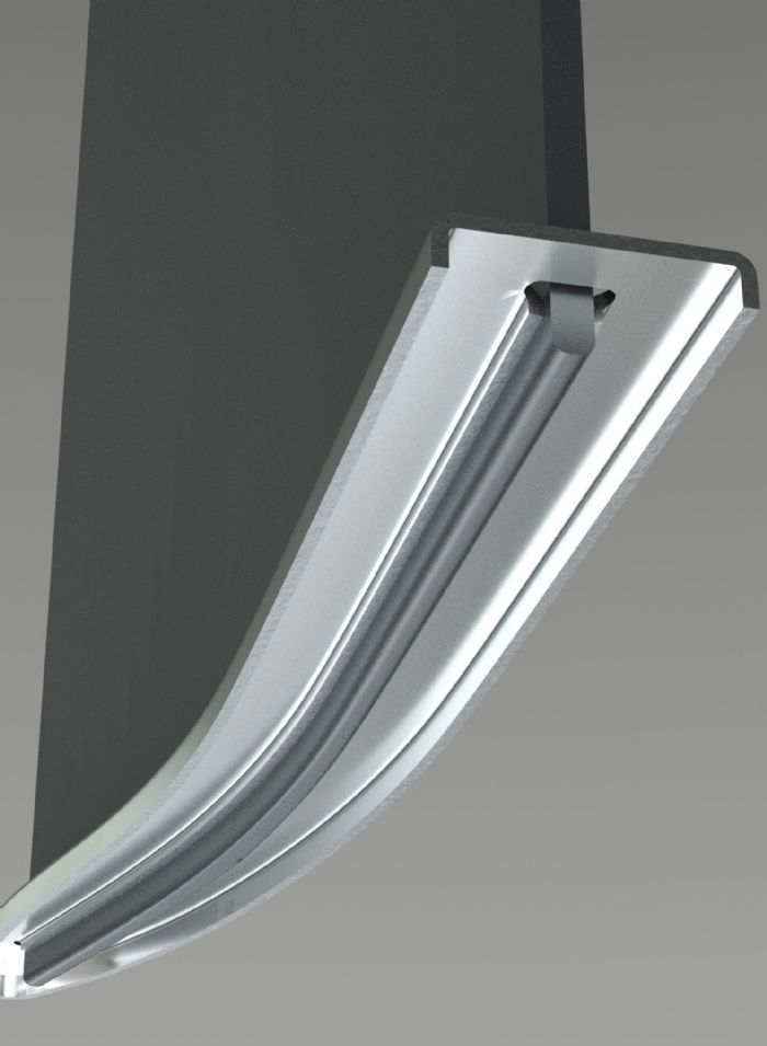

One recent job provided a particular challenge that led to a FortiPhy coating solution, according to Marraccini and Charlie Phillips, sales and marketing manager at Penn United. This involved a part produced from Type 301 quarter-hard 0.010-in.-thick stainless steel.
“The part features what we call a knife slot—a very thin slot through the center of the part,” Marraccini explains. “The forming punch for this slot, formed up 90 deg., is only 0.024 in. wide with a trim punch of only 0.014 in. wide. It’s a fragile piece of carbide tooling, and we found that upon reversal, the material really wants to grab the blade. Without a coating, over the course of only a few hits, the tool will break. The FortiPhy coating solved that problem.”
